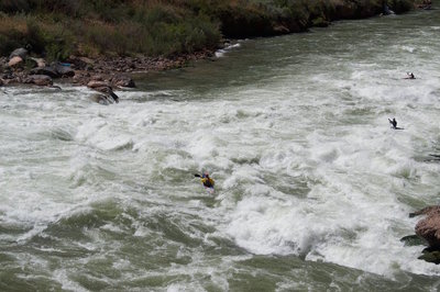

This is what Lava looked like when I was there. We think it was about 12000cfs, but not sure. Our trip leader, the guy in the red race kayak in the front, has done the grand 20 times and said he's never see Lava this chaotic. In the picture, I had not flipped yet. I was driving left as hard as I could, but didn't make it left of the next breaking wave.

In this picture, I'm rolling up after I was knocked over. The v-wave got the kayaker behind me.
Re: Pépé - An extra wide slalom C1
Oh right, I think it must have changed between 2007 and 2013 then because that looks more like a bigger version of what we had at around 8000cfs (I think) in 2013 than what we had at around 10000cfs in 2004 and 2007 where the Vee wave stretched from the edge of the ledge hole to the right bank - it seems much less defined these days and broken up into smaller stickier holes towards the far right. There were always some holes below it but I remember they all seemed to flush.
We had 2 C1's in 2004, I think Gwyn (Ashcroft, Shaggy Designs) got through upright in his high cut Sith, Chris Bolton in a converted Redline needed a roll after the Vee wave but was able to get clear of the holes on the right towards the cheese grater. I smashed my shoulder climbing in Matkatamiba that trip so was on a raft, but I kayaked it in 2007 and then potaged it with the canoe in 2013.
Well done - it's defintiely living up to its grade a bit more these days

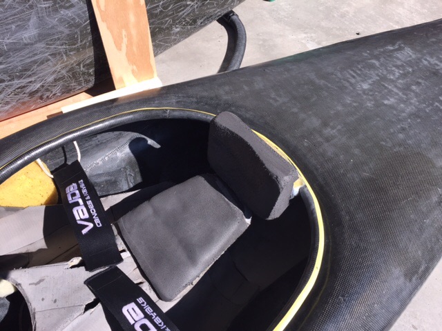

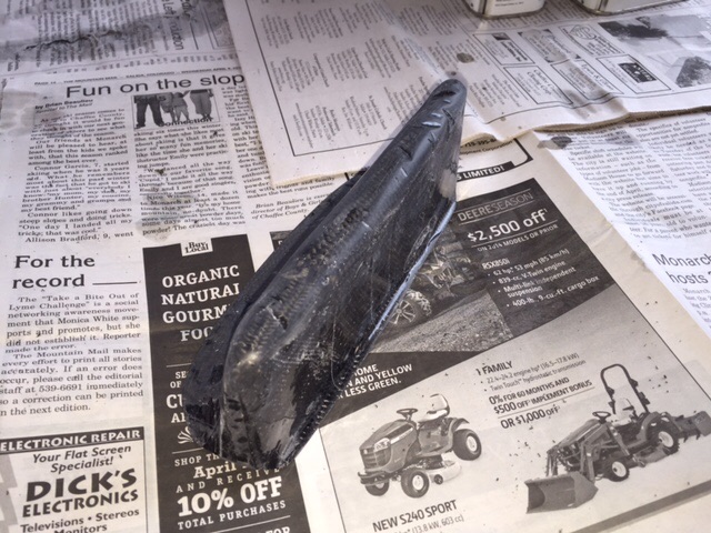

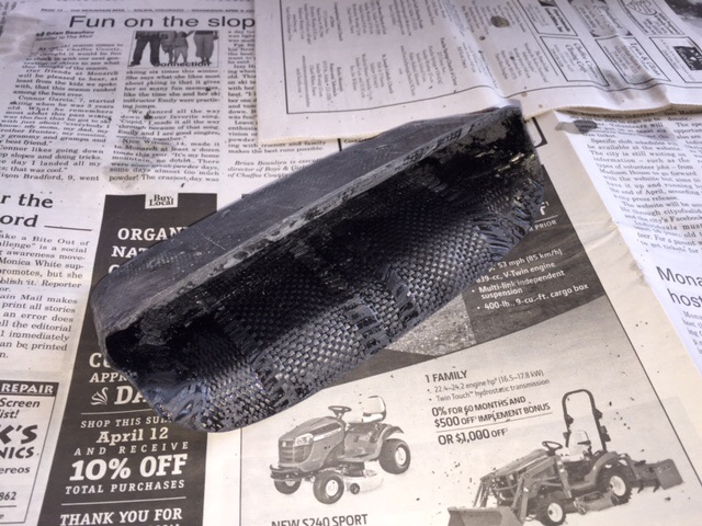

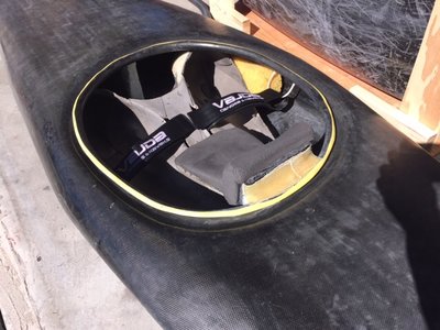

I am really liking paddling pépé both river running on the grand and in our gates here in Salida.
I am having a small outfitting problem. My foam back rest does not stay in place. It seems itnisntoo far from my back to the cockpit rim to use just foam. I tried a few ideas that didn't work before deciding on molding a carbon fiber backrest. It should be very similar to river elf hip blocks, but bigger and symmetric.
I carved a mold in two halves from mini cell, covered it in packing tape and then layed carbon fiber and epoxy into it.
After it cured, I pulled the two halves of the mold apart to release the part.
Even after trimming and sanding the finish is not very good, but it will be mostly covered in foam and Kevlar tape.

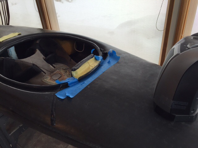

Here I am glassing the backrest into the boat. I think there might be a lot of pressure on it so I re-enforced both the top and bottom with two layers of Kevlar tape.
Next I glued on a block of foam and shaped it to fit my back.
After a few test paddles and adjusting the foam thickness I'm happy with it. It is comfy and really holds me in my kneecups tightly.
Matt
Matt
