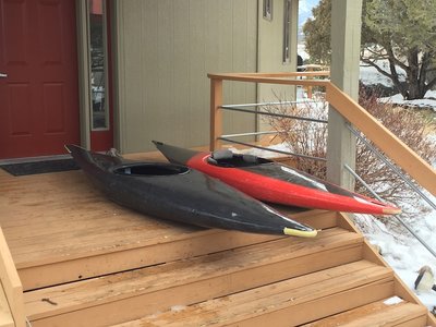

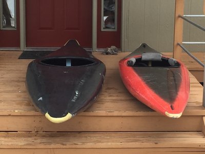

And here are two pictures to show the size comparison with a Vajda Lizard XL.
Pépé on the left and lizard on the right.

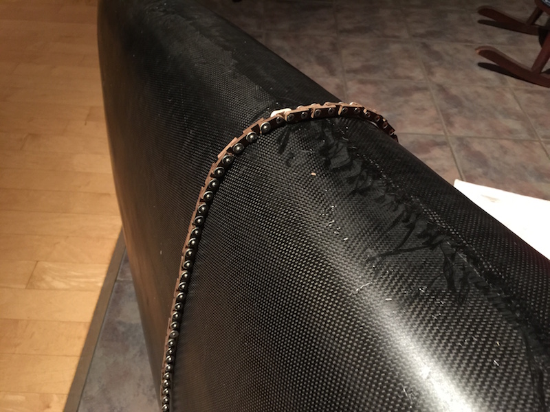

I'll attach a few pictures showing the issues I had building this boat.

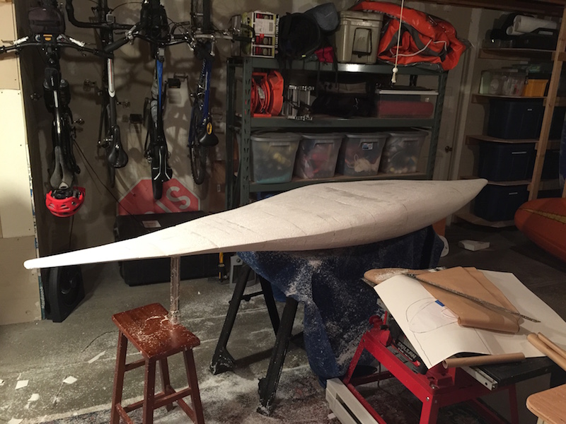

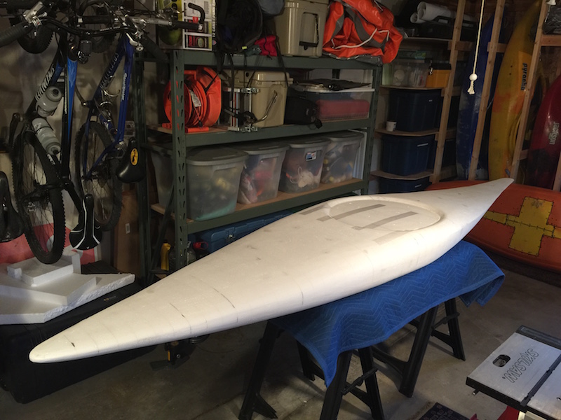

For the foam plug, I decided to use white construction foam that is 2 1/8" thick and comes in 4 x 8 sheets. It took 3 sheets total. To build up the plug, I cut out profiles of the boat and glued them together. For the profiles I used some existing boats for reference. I have access to a Loco, Makao, Lizard, and a Wind C2. To take the lines for these boats, I made a chain girth device by pop riveting together a bunch of little pieces of pegboard. There is just enough friction that it can be made to follow contours but still hold its shape if handled carefully. There is one extra small link that I used for the very sharp edges of the stern. This device is simply wrapped around the boat and then the contour is transferred to a poster board. On the boat being measured, I marked out every 2 1/8" and a center line on the hull and deck. I also set up a string a few inches off the deck to take offsets for each profile. The clothes pins are used to mark the center line of the the deck and hull for each profile. I put all the profiles for the hull on one poster board and all the profiles for the deck on another one. You can kind of see the shape of the boat from these lines.
This is the bow.
This is the bow.

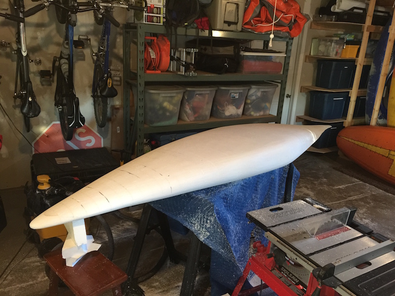

Re: Pépé - An extra wide slalom C1
This is the stern.

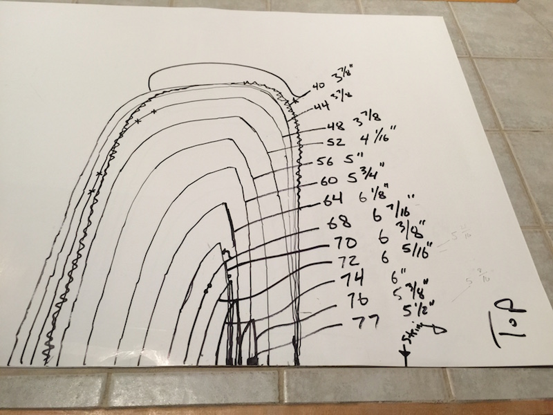

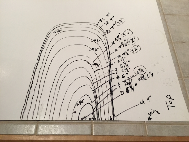

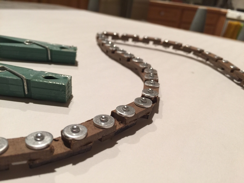

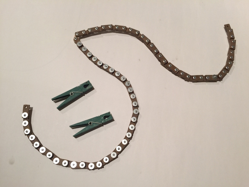

Next I modified the profiles as I thought best. Then I cut out thin plywood templates for every 8 1/2" of length of the boat. I would then use the two templates for each 8 1/2" section to cutout four layers of foam with a hot wire cutter. I glued all these profiles together and shaped and sanded the plug smooth.
Here is the plug after some shaping. You can see the 8 1/2" sections here.

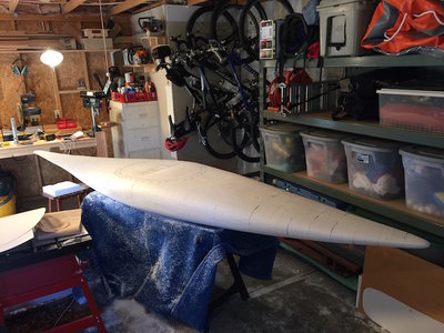

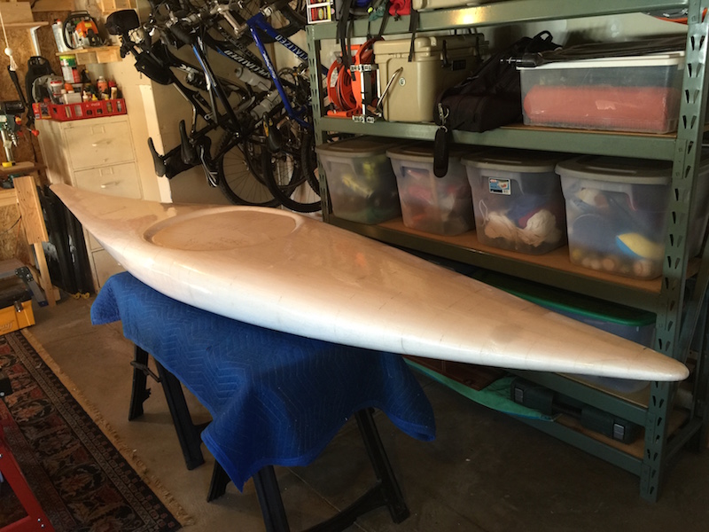

After more shaping and sanding and cutting in the cockpit recess with a router.
