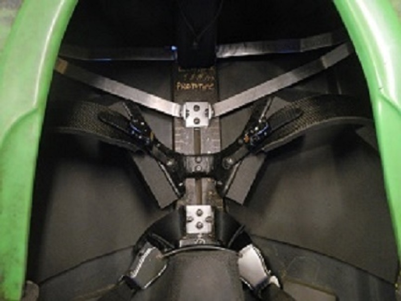

I would use the snow board straps for your knees and get webbing/airplane buckles for your thighs. I would love to post pics of my newest setup but can't figure out how to do it without first uploading to a photo site... I'm kind of over it when it comes to registering on the web.
Is there a way to upload pics directly to here?

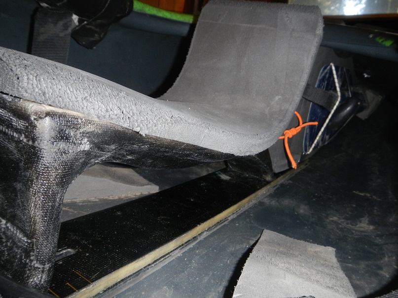

Larry Horne wrote:Thanks Mike, Was that there the whole time? :oops:
The ability to add a photo directly from your computer hasn't always been there. It was added a while back to make it easier for folks to share photos. I think it's location causes folks to miss it.

Larry, that is a thing of beauty! Not sure I'll be able to replicate such design.

Pea pod, if you did replicate I would have to send my goons to pay you a visit :wink:
Check the knee straps out. The simple looking but very strategically placed knee pads are key to this setup too. I've done these with standard run of the mill snowboard straps for years. They are as solid as a knee bulkhead, but fully, and instantly, adjustable. Like a bulkhead, they stay put, so it's not something you need to touch getting in and out of the boat. Access to the front of the boats is not blocked.
Super comfy and solid.

Larry,
Your description of the knee straps sounds very attractive, and is something I will definitely work on.
Any tips on the kneepad strategy? My plan is to velcro some minicell wedges to allow for some adjustability in lieu of your wicked setup.
Is the lateral bracing near the bow pillar in those photos screwed into the original kayak foot-rest hole?
I can't get the first photo to enlarge, so I can't see where the knee strap is anchored to the hull.

Pea Pod wrote:Larry,
Thanks for the tips, one and all!
The outer end of the strap needs to be anchored as low as possible and 6" or so behind your knee. There is no hole in the hull there, so you can drill one or make a plate that cantilevers back and down from the existing foot brace bolts. Mine in the pic is carbon fiber, but a 2"x1/8" aluminum bar works great. If I recall, LL is the only boat that only has one foot brace bolt.. so obviously a cantilever wouldn't work. You need two bolts for the cantilever plate. Another hole filled with a bolt is not a problem.
You want your knee to be as far into the corner of the hull as it can be, but there will be a little gap there between the strap and your leg.. The knee pad has a corner that is loose and wraps up into the knee strap. This fills that gap and makes the strap wrap the leg better.
Once you figure out the best location for the wedges, they don't need to adjust (for you). I would make them solid to the rail and glue them in.
The inner end of the strap can bolt to your rail. Just sit in there and find the location that feels best, and wraps your leg the best. As you can see I like mine to be angled perpendicular to the angle of my thigh. The straps are about 5-6" up from the end of my knee, but this is all just personal preference.. all of it :wink:
Yes on the lateral bracing.
