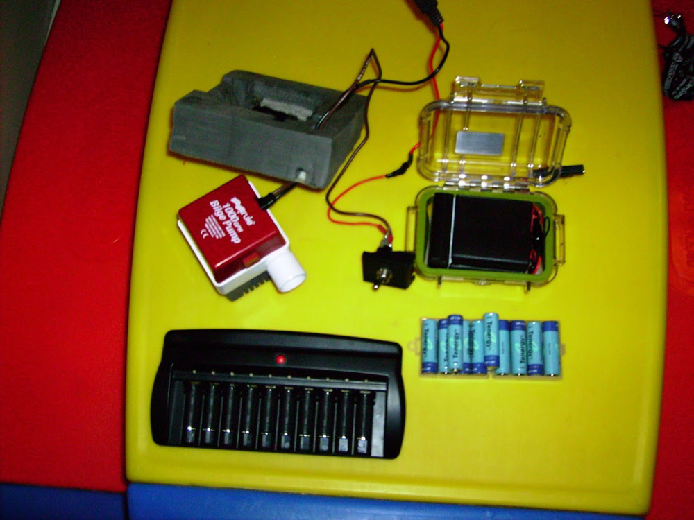

We have to agree that the closed L'Edge is heavy enough by itself without adding a 5 - 8 lbs+ lead acid batterie pack in it. I suggest you make a batterie pack out of NiMhs 1.2v. What you need is 10 NiMh batteries, 2x 4AA batteries holder, 1x 2AA batteries holder and a small Pelican case. These batteries have better performance than a lead acid batterie and the whole setup is super small and light. My batterie pack weighs about a pound and a half, give and take. I have another 10 spare batteries than I can take with me for long trips. A bit more expensive, and a little longer to make than a traditional lead acid kit, but definitely better. You can look at buying the stuff you need on eBay if you want to save a bit of $$.
This photo is from someone else's setup, mine is almost identical. Good luck.

I'm just gonna offer a suggestion to amend the design o the NiMh setup as I have plans to do something similar.
The 1.2V AA cells will give you 1.2V at maximum charge and loose some from there. Because most 12V alternators actually produce between 14-15V (needed to charge 12V lead acid battery's) vurtually any 12V accessory or motor used in marine or automotive applications will handle 15V without any trouble. For building a battery pack for a bilge pump out of 1.2V cells, go ahead and use 12 instead of 10 1.2V AA NiMh battery's (12x1.2V=14.4V), it'll pump a bit faster, last a bit longer and may actually be better for the motor as low voltage can be very hard on electric motors.
Also, if you decide to go with NiMh battery's, do some research as not all of them are created equal. Some have much higher capacity, can be rapid charged and have low charge loss in storage.
Having said all of that, if you wan to keep it simple you could use a 2.7Ah lead acid battery (not crazy heavy) and have two or just charge every day. I have a 2.7Ah battery that'll last two days running hard on the Gauley.
