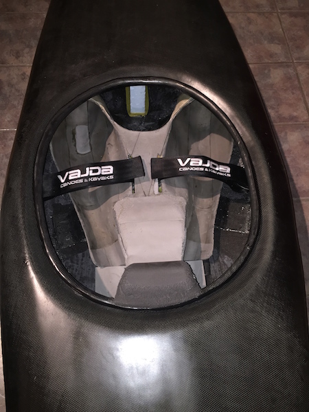

And here is the outfitting as it stands now. I increased the size of the back rest and added a little foam to the knee cups. I also made the opening to the front of the boat a little bigger.
You can also see what is looks like with two coats of clear acrylic spray paint.
One problem I did have is that I got the cockpit 1/2" too far to the left. Not sure how that happened, but it doesn't really hurt anything and is hard to even notice just looking at it.

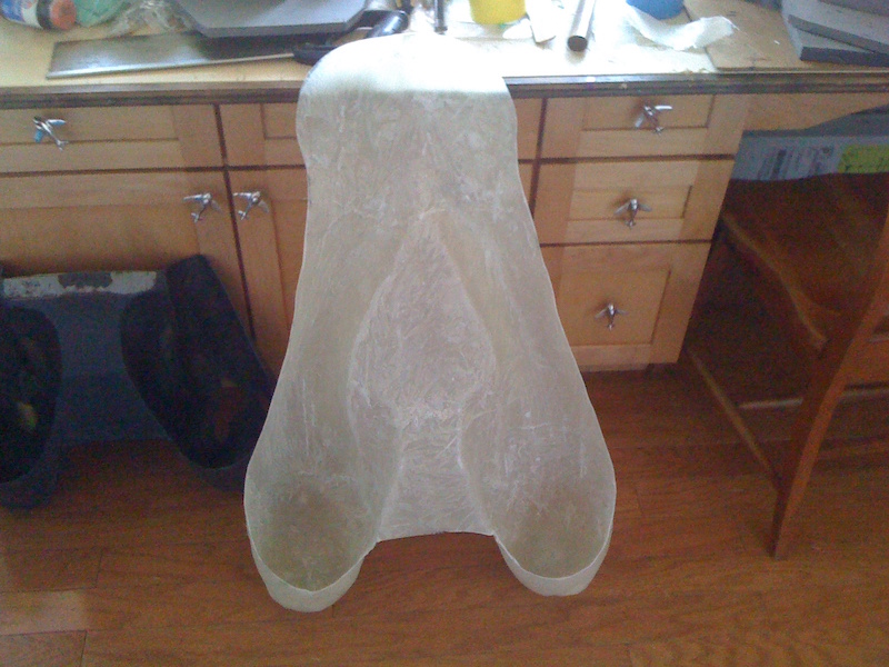

Amazing job in general but what I'm most interested in is how do you make the leg casts? I want that in my boats!

As for the knee cups. First you sit in a box like this full of plaster to make a plug.

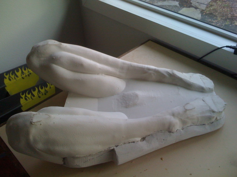

Then you paint the plug with mold makers urethane rubber. Then you pour some plaster in the rubber to support it (maybe called a mother mold). After you break off the plug you end up with something like this.

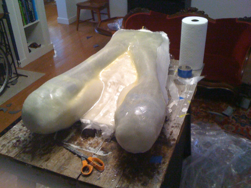

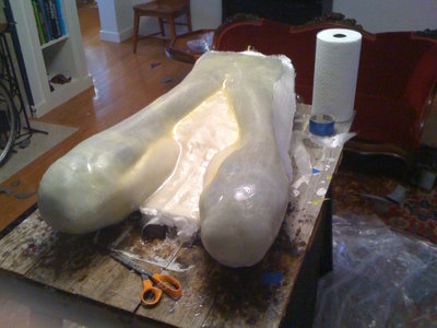

Then you cover the rubber mold with foam of whatever thickness you want to use in your knee cups. If you want the tightest possible fit, you use no foam, but it's pretty painful as I know from my first one. Then you layup your glass or carbon fiber over your mold like this.

Next you pull out the mother mold. This loosens it enough to pull the rubber out of your knee cups.
Then you just add a foam liner and a foam seat.
It is very comfortable as you are supported by the length of your leg from you knee to the top of your foot.
