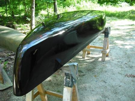

Gorgeous plug! That was a lot of sanding and polishing...
Hull looks a bit like an open Amoeba...
Speaking of the Amoeba, how many have you made so far? The more I paddle it the more I like it - I think you have a real winner there if more people hop in it!

Any more info on the boat... or comparison to the Amoeba design wise?
Re: The "Shacho"
Hey Adam,
I never even considered the AMOEBA when I designed this boat. I can see how you might think it's similar though. The SHACHO is wider and not as hard chined.
I plan to start building the mold this week.

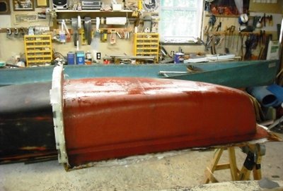

The first half of the mold is complete. Waiting for more fiberglass to start second half.
JKaz......
Re: The "Shacho"
The second half of the mold will be finished this week. A couple weeks of curing, then the first boat. Demos will available on the Fife section of the Deerfield R.
