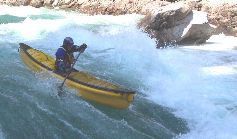

I have hippads and foam in the sides.
It rolls much dryer that way.
I also have oversized bags in it.
To put foam in, trace the shape of the hull in cardboard, then cut that shape from minicell foam. Glue several stripes of those together and fit it all along the cockpit sides. After that, you can add more foam where needed and remove foam elsewhere.
It's real easy if you have a bandsaw. You see it in many other boats as well.
Cheers, Jan
Ps: this is the best pic I have at the moment. It's not very good but gives you an idea.
Cheers, Jan

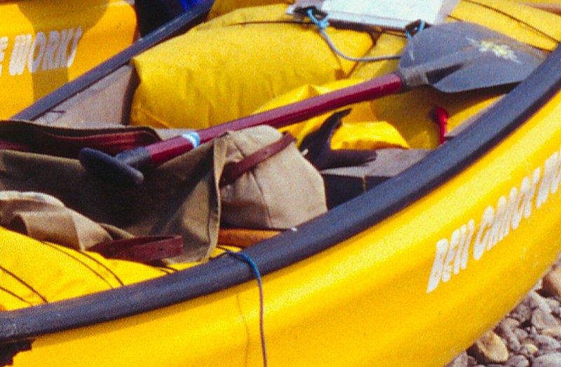

Raff, well, I don't really remember. I know I have the stern bag that came from Bell. Then a longer (prolly 60 inch) for the bow bag.
The boat rolls very dry. I often roll it in an eddy to get rid of most water when I can't get out otherwise on busy canyony sections.
I also increased the length of the decks as martin indicated but not nearly as extreme. I just used a bunch of duck tape (in style, of couse, using black tape) to increase the bow dryness. The factory decks are kinda ridiculously short.
Cheers, Jan
again, not the best pic but gives you an idea of the front bag and the decks.
Cheers, Jan
