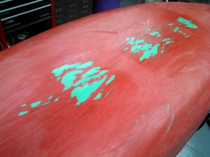

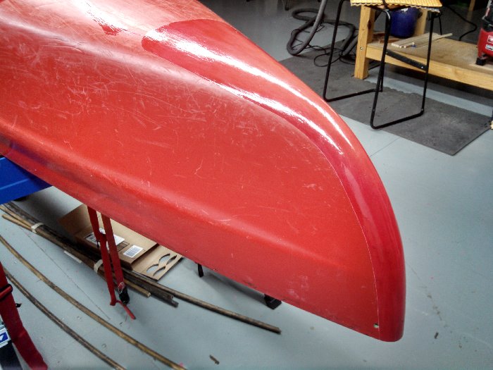

This is a friend's Ocoee I'm refurbishing with all new wood and some hull repairs. In the "before" photo you can see that the hull is in decent but worn condition. There are three significant soft spots underneath the front edge of the saddle. The vinyl layer was worn thin at the stems and throughout the entire center area of the boat, including the chines. I started by thoroughly washing the hull, then cleaning the work areas with acetone.

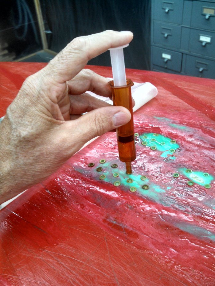

I used a heated metal rod to punch holes into the soft spots so epoxy could be injected. After the epoxy cured I used a sharp chisel to cut away the excess epoxy and the ABS that bubbled up around the holes.

One of the criticisms of epoxy is that it is too rigid for this application. I did some test pieces with West System 105 resin & 207 hardener. Some were just epoxy alone, of various thicknesses. Some had a layer or two of S glass. They were all quite flexible. I was convinced that 105/207 alone would be plenty flexible and strong enough for an injected filler, so that's what I went with.
I used a heated piece of metal rod to punch holes through the outer layers, making several holes in each soft spot. I put some holes near the edges. By poking around after the epoxy cured I feel confident I fully filled the voids. I think the only thing I'd change is to make only one central hole large enough for the syringe injector, and make the rest smaller just for air to vent out.
I recommend that you fill it and leave it alone, if you try to clamp something over it or otherwise apply pressure, you're just going to squeeze out resin. The point is to keep it in there to completely fill the void.
