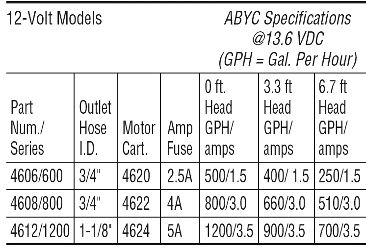

I'm gonna give ya'll fair warning about that battery, It may or may not work, The problem is that most of the T1200's pull more than 4.2 amps upon start-up. Even thought the specs say it only pulls 3.5 amps continuous, its gonna pull more from the battery during start-up under load.
See attachments. These batteries have a polyswitch built into them to proctect them from damage, If the pump draws more than 4.2 amps upon start-up it cause the battery to shut down. Thus no Pump.
I've had Much Larger Li-Ions with 7amp poly switches fail to operate under load (ie. Water in the Boat)
And I also have two 14.8v Li-ion with 7amp poly switches built into them that operate flawlessly
So it is a wicked science !
