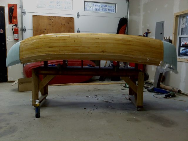

And thanks to Jeremy for the followup picture - I had been wondering how one would form the blunt entry that most WW open boats have. The strip canoes I've seen all have a very fine entry.
Actually, I guess the question still stands - if you were doing a one-off, how would you form the ends?
