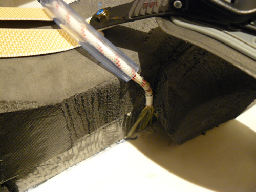

This is the view onto the saddle. You see:
- belts that run through the string from ratches to the quick release
- a kevlar string laminated to the carbon backbone, plastic hose to keep stress from it
- snowboard ratches
- minicell saddle
- carbone fiber backbone
The rocker profile for the backbone I took from the original Liquidlogic rail for the kajak seat.
http://www.singletrailz.eu/verschiedene ... 9/seat.jpg

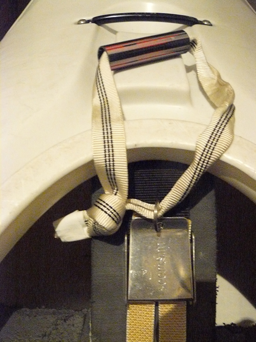

Quick release:
Just a quick release of a diving belt fixed with a diving belt and a bolt through the hull. You open with one zip the spraydeck and the quick release. First time I saw this solution was in Angus´Burn and I like a lot the simplicity of it.
http://www.singletrailz.eu/verschiedene ... hlinge.jpg
- snowboard ratches
- minicell saddle
Quick release:

I think I get it.
Your quick-release buckle sits on the pillar near the front of the cockpit, and straps run toward you knees and under the sleeeved Kevlar rope. So, it's the leverage of this rope around the pillar that provide the "attachment" point of your thigh straps.
I also like releasing the straps with the skirt pull.
