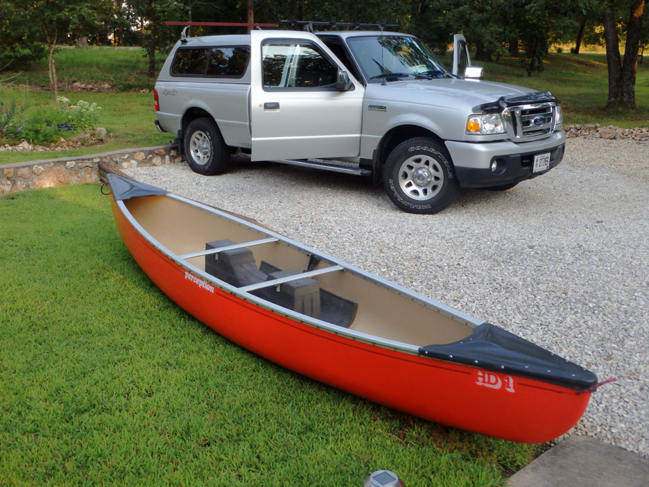

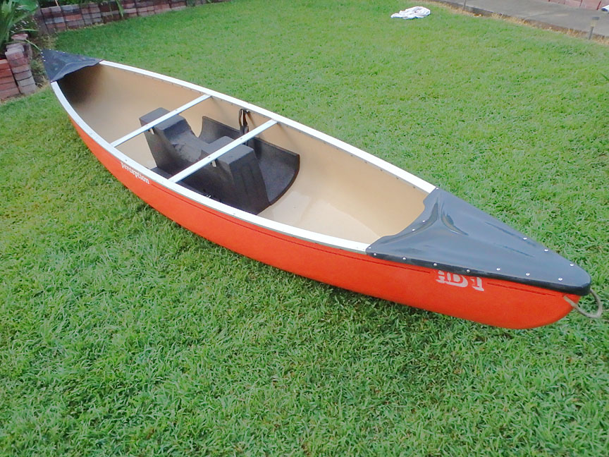

Old School...........
A like new condition, rarely used Perception HD-1.
Found in an old, unused garage, where it had been stored for many, many years.
BOB
BOB

Re: Old School...........
Blackhawk wrote: A like new condition, rarely used Perception HD-1.
BOB
Wow, memories.
I paddled one for a short time during my NOC stint in the 80's. Beat up and yellow? Then a ME, Sunburst 2, glass Flashback, a series of Capers augmented by a Cyclone for gates.
Will it be on the water?
