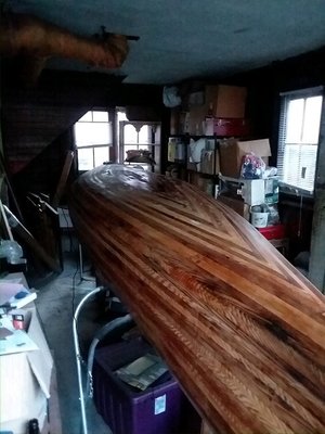

Once I'd peeled all the glass off of the hull, I found some places on the bottom of the canoe (where the glass had pulled away the worst) where the wood had become a bit pitted, and shrunken, like redwood and cedar does when its continually exposed to water but hasn't quite started to rot yet.
Most of this damage is in the redwood strips, and I'm trying to figure out what to do with it. Redwood is tricky to work with at the best of times, and this wood is not at its best. It wants to splinter really bad. I keep going lighter with the sandpaper but I've come to the conclusion that I'll never be able to properly sand this out. It's too deep and the wood wants to splinter too much. On the upside, its only in a few places. So, I really don't want to use a putty to fill all this in, as it will be ugly. What I'd like to do it hit the boat with a stain (stains cover up a lot of sins) and then hit it with some oil-based poly to fill in the gaps and cracks, sand, repeat, until I have a smooth (and pretty) surface to work with. I have read that epoxy resin will not stick to oil-based stains but WILL stick to polyurethane, and polyurethane will stick to oil-based stains. Has anyone ever tried this? Does anyone have a better idea?
At the end of the day, this boat was never a 'floating furniture' boat, but was a very pretty working canoe, and that's what its going to be again...a working canoe. That said, I still want it to look as nice as I possibly can, and using wood putty or bondo to fill the gaps makes me want to throw up in my mouth a bit. Ideas?

In similar situations (on furniture, not boats), I take sanding dust and mix it with epoxy, in about a 50/50 ratio, and fill the defects/cracks/etc. It works really well, and if the color of the sanding dust matches the color of the surrounding wood, it blends in very nicely. It will take stain (but as you are aware, make sure your stain is compatible with your top coat).
You want to use sanding dust, not sawdust. You want the very fine stuff that is collected from sanding wood, not the shavings from cutting wood.
I would use West System epoxy on the hull, with the special clear hardener. Put on a top coat of spar varnish for UV resistance.
