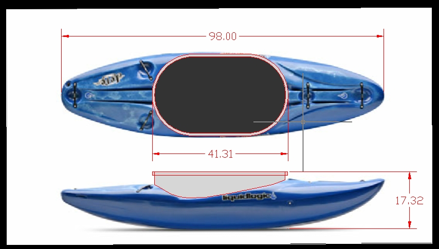

Re: K1 to OC1 Conversions?
Here's a mockup in CAD using the photo of the boat on the LiquidLogic website, and dimensions from the HDPE barrel I picked up last weekend.
Edit: Dimensions shown are decimal inches.
