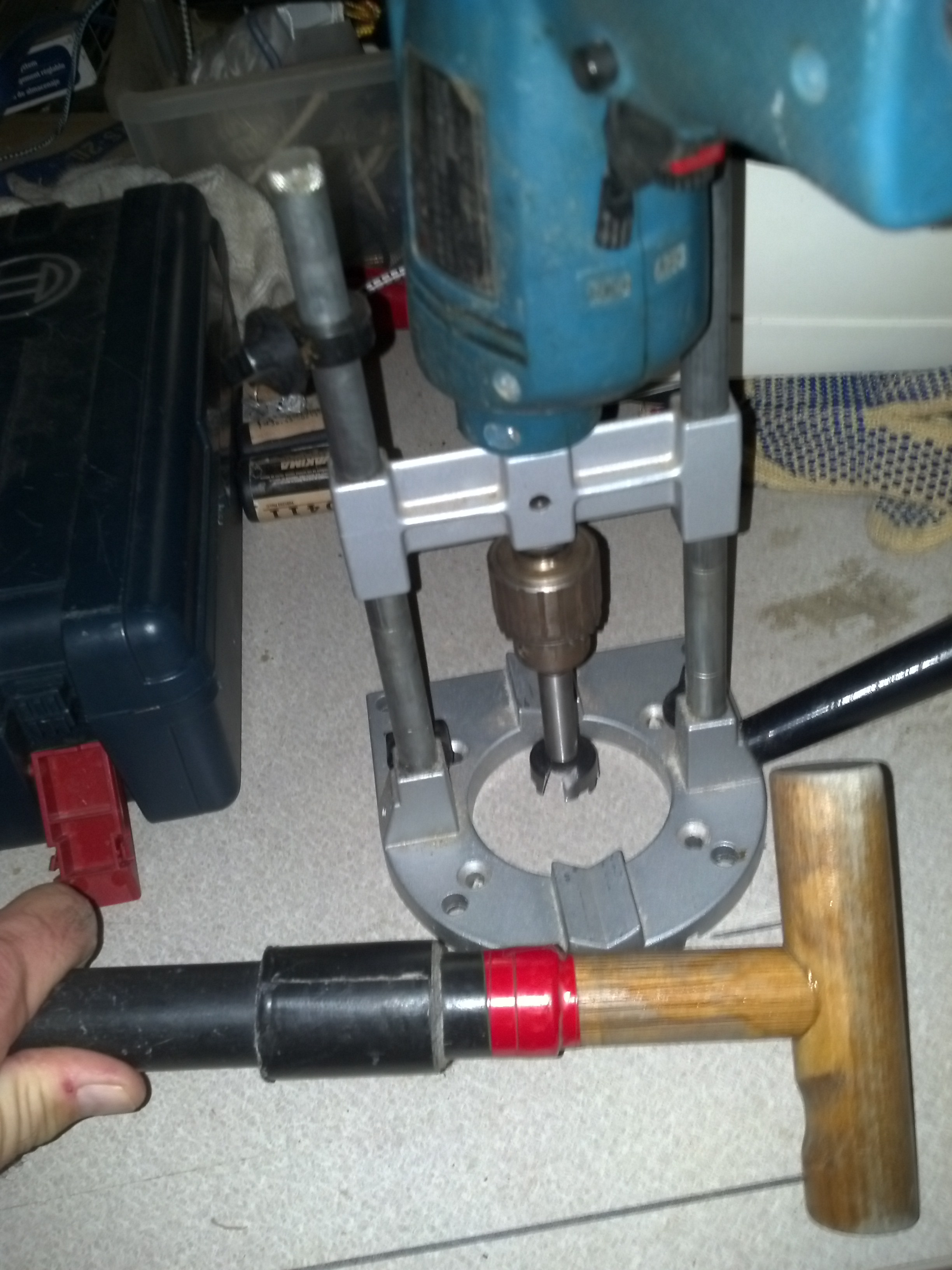

My approach was similar to Griffen's, but i used the opportunity to lengthen the paddle. 1 dowel close to the ID of the shaft, a larger dowel for the grip (1.25" for me, I'd like larger), a Forstner bit the size if the first dowel, a drill press/jig (free hand could work) and gorilla glue or gflex.
The red tape is electrical tape. Below that is my gorilla tape.
