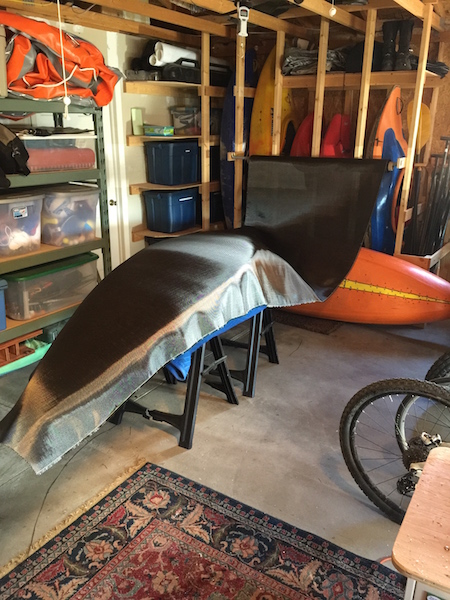

Now I cut out 5 decks and 5 hulls from the carbon. I cut them at about 15 degree angle to waste less material. When laying up, I turned every other layer upside down so that the carbon fibers would run in two different direction.

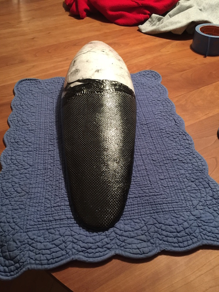

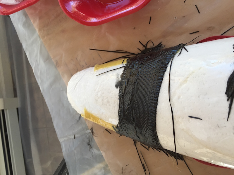

I did two test layups to practice wetting out the carbon, figure out how to do the sharp stern edge and feel the stiffness of 5 layers.
My first idea of wrapping the carbon around the sharp edge did not work. It would alway lift up and form air bubbles underneath.
My second idea worked great. I first layed up two layers of kevlar bias tape on the sharp edge using thickened epoxy. Then I layed up 5 layers on the hull letting it over hang the edge, waited for it to gel, then trimmed it flush with scissors. Next I layed up the 5 layers of the deck letting it over hang the edge, waited for it to gel and then trimmed it flush. It is basically laying in the inside seam first.

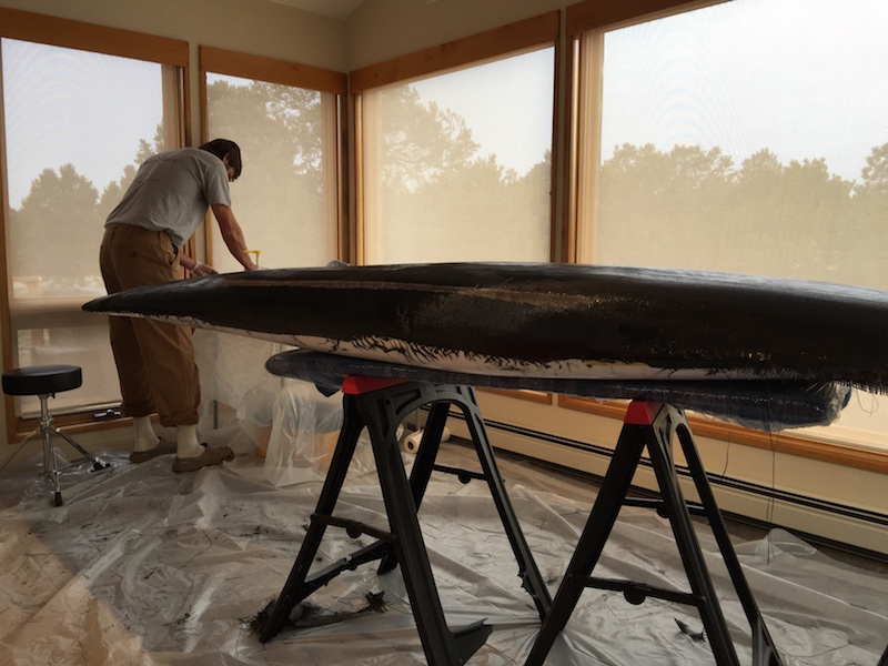

Next we did the hull. We painted epoxy on the hull. Then we layed down one layer of carbon. Then we completely wet it out. Then we layed down the next layer and completely wet it out. We repeated this until all layers were done.

We waited until the hull was pretty stiff and then turned the boat over. I was glad the whole thing didn't drop off the plug. While the hull was stiffening, I kept painting epoxy on the kevlar bias tap in the stern and the sides of the bow where the deck would overlay. I wanted to make sure these areas did not cure too much so that I would get a good bond.

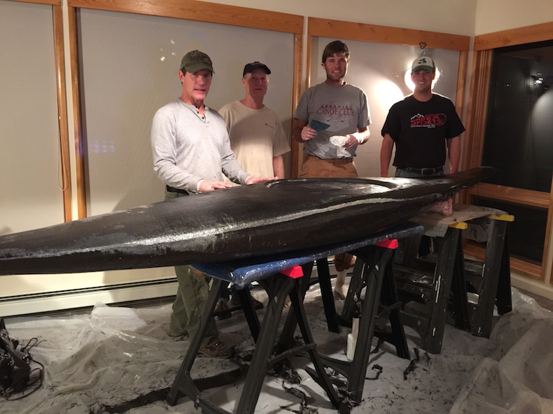

Now we did the deck the same way as the hull. I thought the cockpit recess might give us some problems, but the carbon fiber conformed down into it easily. The hardest part was probably rolling out the carbon each time. We would get off a little one way and then have to work it back the other way. I did cut the carbon pieced oversize to begin with and trimmed them to the final size after they were on the boat.
Thanks to Scott, Ryan, Denny and my wife Jennifer for giving up their day to help me with this.

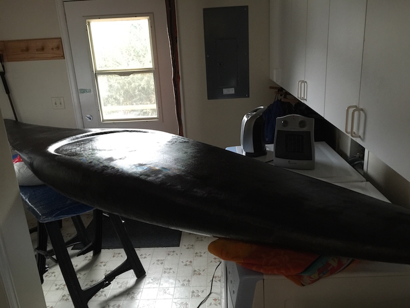

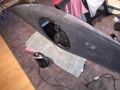

Here is where I cooked it overnight to help it cure. According to west systems, this can help with final strength. I got up to about 120 degree F.

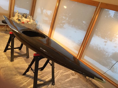

Next I painted on two coats of epoxy. I had some trouble with bubbles, but just decided to sand them out later.

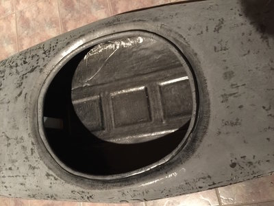

Here is a look at the stern edge on the inside. Looks like a perfect inside seam. You can also see the full length 2" foam pillars. I could have saved some weight with 1" pillars, but I already had the 2" foam.

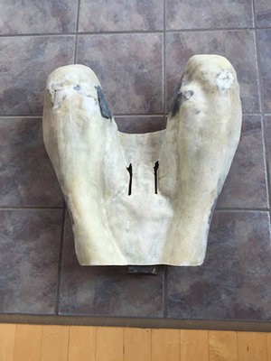

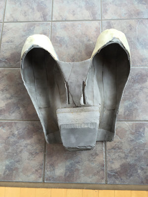

And then my knee cups / pedestal that I took out of my Lizard. These weight 2.5 lbs. I wanted to make a new set from carbon fiber, but I ran out of time.
