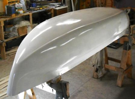

Sanding, more sanding, then a bit more sanding, then I'll make the mold.

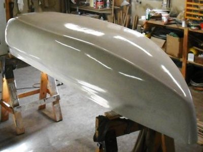

Just sprayed the STINKEYE plug with a primer, sanding session round 3 starts next.

Wow!
I just have one question: How do you check that both sides become equal? I have seen pictures of Mike stripbuliding the centre of the plug so I know how that works, but what about the final 1/16 of an inch to get i perfect?
Re: Coming soon....
I don't know about Kaz, but for me a 1/16" tolerance is not a practical goal. 1/8" (or more) maybe. Much of my final finishing is done with crude templates, a tape measure, and a close eye comparison. In performance terms, you'll never notice a little asymmetry.Barskekarsten wrote:Wow!
