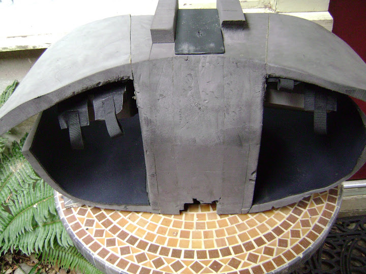

Scott, I know this might not be the answer that you are looking for, but have you considered forming some minicel wedges which can be held to the top of your bulkhead with velcro. I did this in my Fink so that I could change the fit when I went from winter boating in a drysuit to summer in swim trunks. Realize that I also have straps in the boat. Here are a couple of photos:
Marc
Marc
